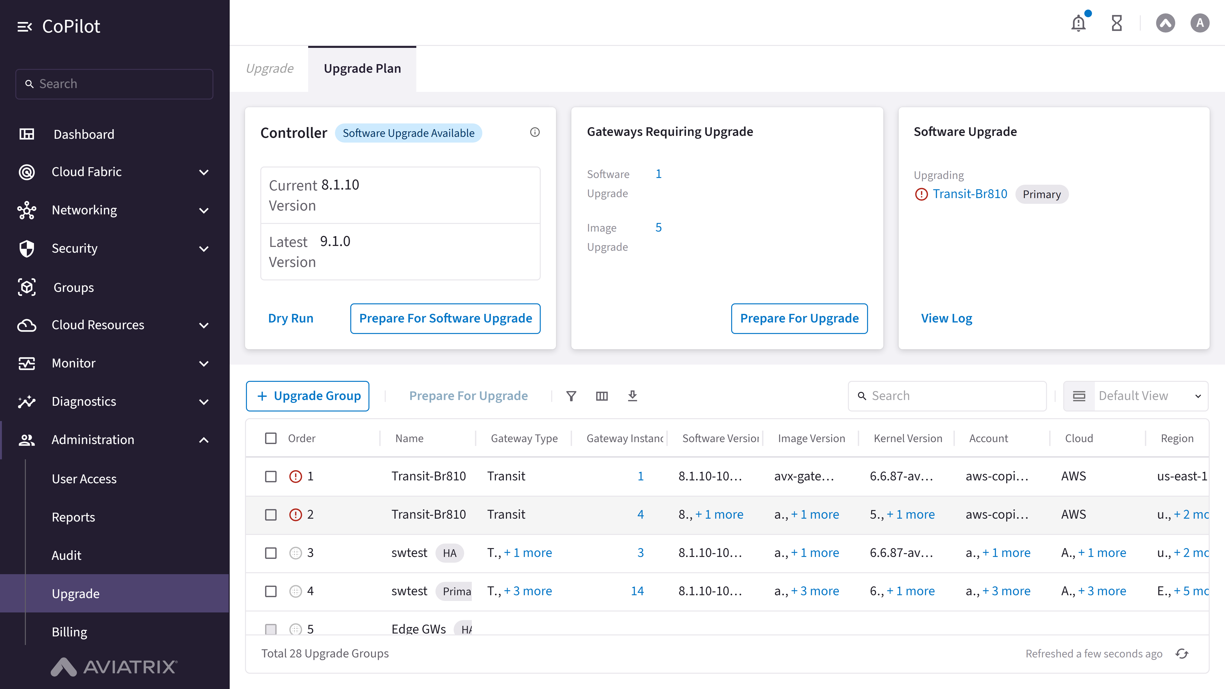

The Upgrade page helps you keep the Controller and gateways up to date with a rolling selective upgrade process. View controller version information and gateway upgrade requirements, and create or manage upgrade groups so you can upgrade gateways in logical groups and minimize disruption.Elements
- Controller: Controller version information section showing Current Version and Latest Version.
- Dry Run: Button to perform a dry run of the upgrade process.
- Prepare For Software Upgrade: Button to prepare the controller for software upgrade.
- Gateways Requiring Upgrade: Section showing count of gateways requiring Software Upgrade and Image Upgrade.
- Prepare For Upgrade: Button to prepare selected gateways for upgrade.
- Software Upgrade: Card showing current software upgrade progress.
- View Log: Button to view upgrade logs.
- Upgrade Group: Button to create a new upgrade group.
- Show filters: Button to show filters for the upgrade groups table.
- Select columns: Button to select columns for the upgrade groups table.
- Export: Export button to download upgrade groups data.
- Search: Search box for filtering table content.
- Default View: Dropdown to select default view or modified view for the table.
- Save View: Button to save the current view configuration.
- More Options: Button to access additional view options.
- View Gateway Instances: Button to view gateway instances for an upgrade group.
View Upgrade Plan
View Upgrade Plan
To view the upgrade plan:
- Go to Administration > Upgrade.
- The page appears with Controller version info, Dry Run, Prepare For Software Upgrade, Gateways Requiring Upgrade, upgrade groups table, and Upgrade Group.
- Optionally, use Show filters, Select columns, Export, Search, or View Gateway Instances to inspect groups.
