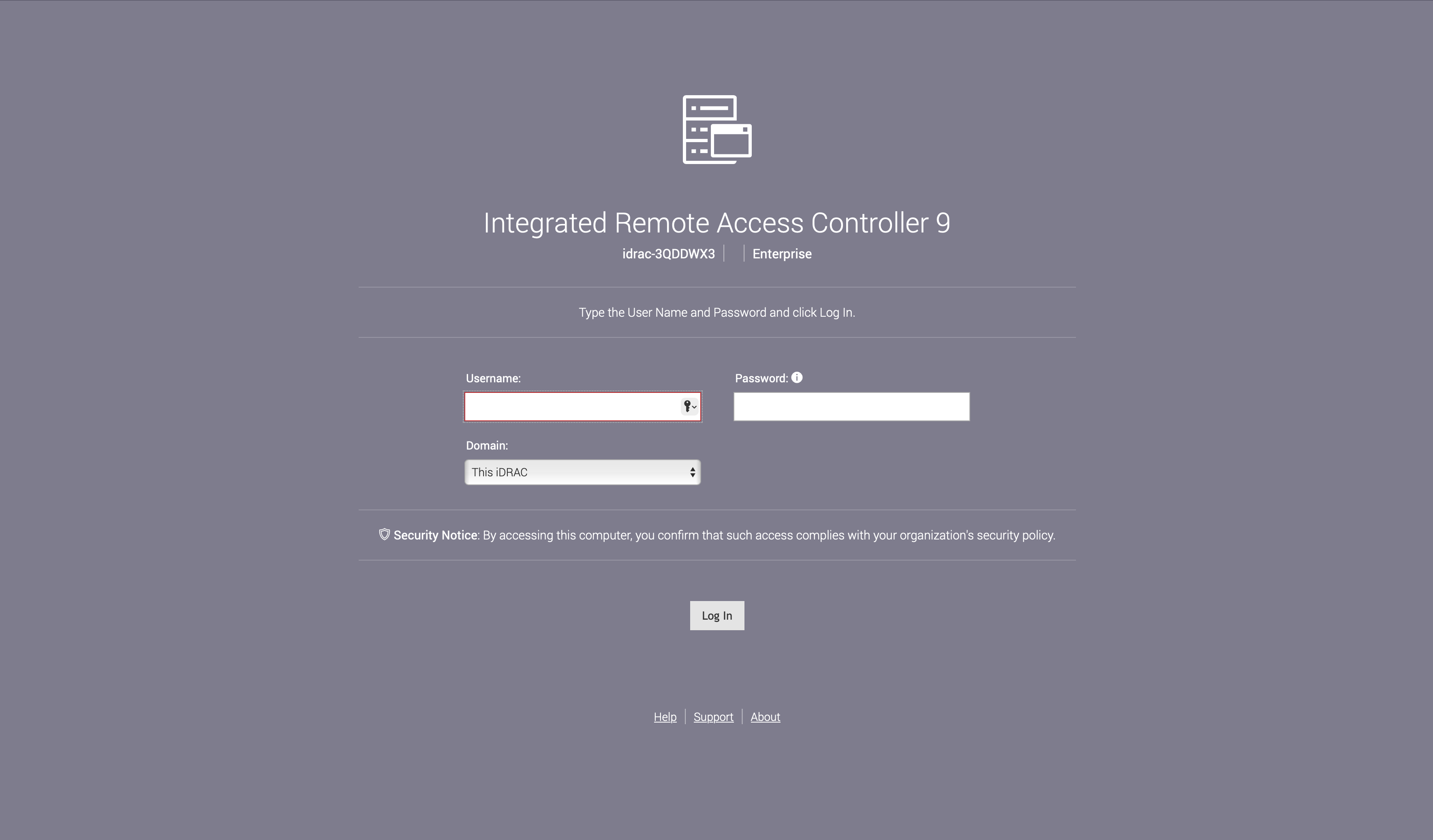

  1. From the jumphost, login to the Dell server’s iDRAC UI.

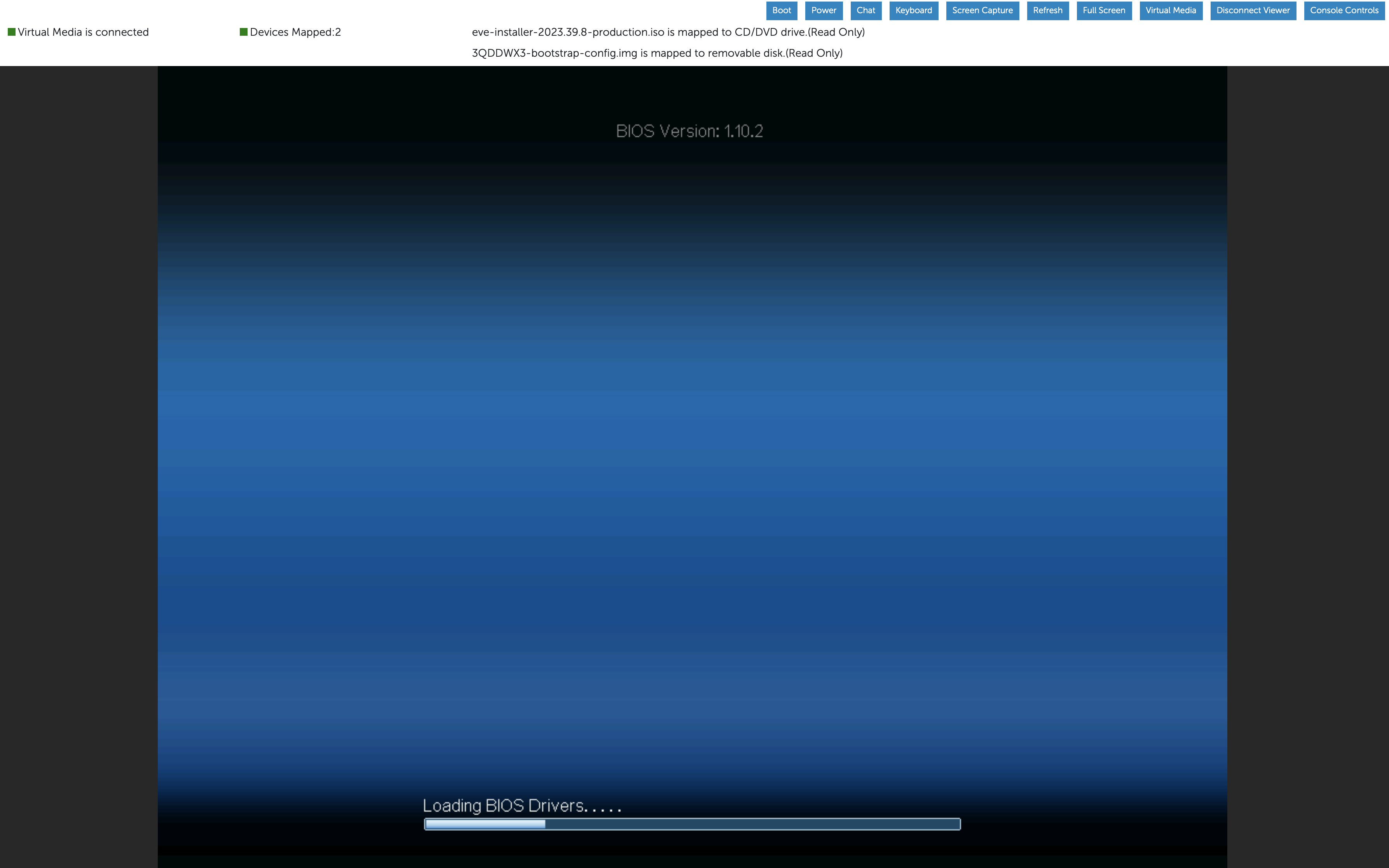

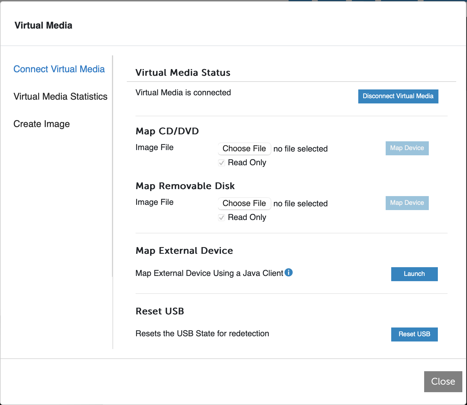

  1. Open the Virtual Console to the server. On the Virtual Console window, click Virtual Media > Connect Virtual Media > Connect Virtual Media. Virtual Media should show up as connected.

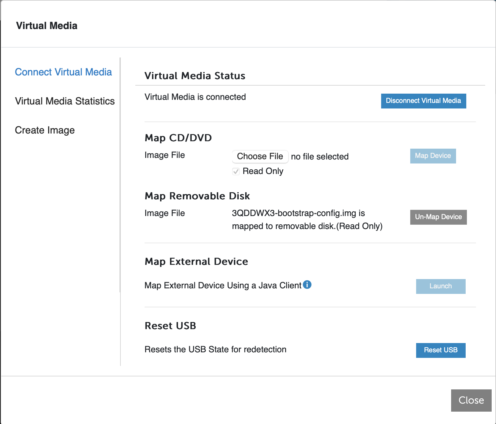

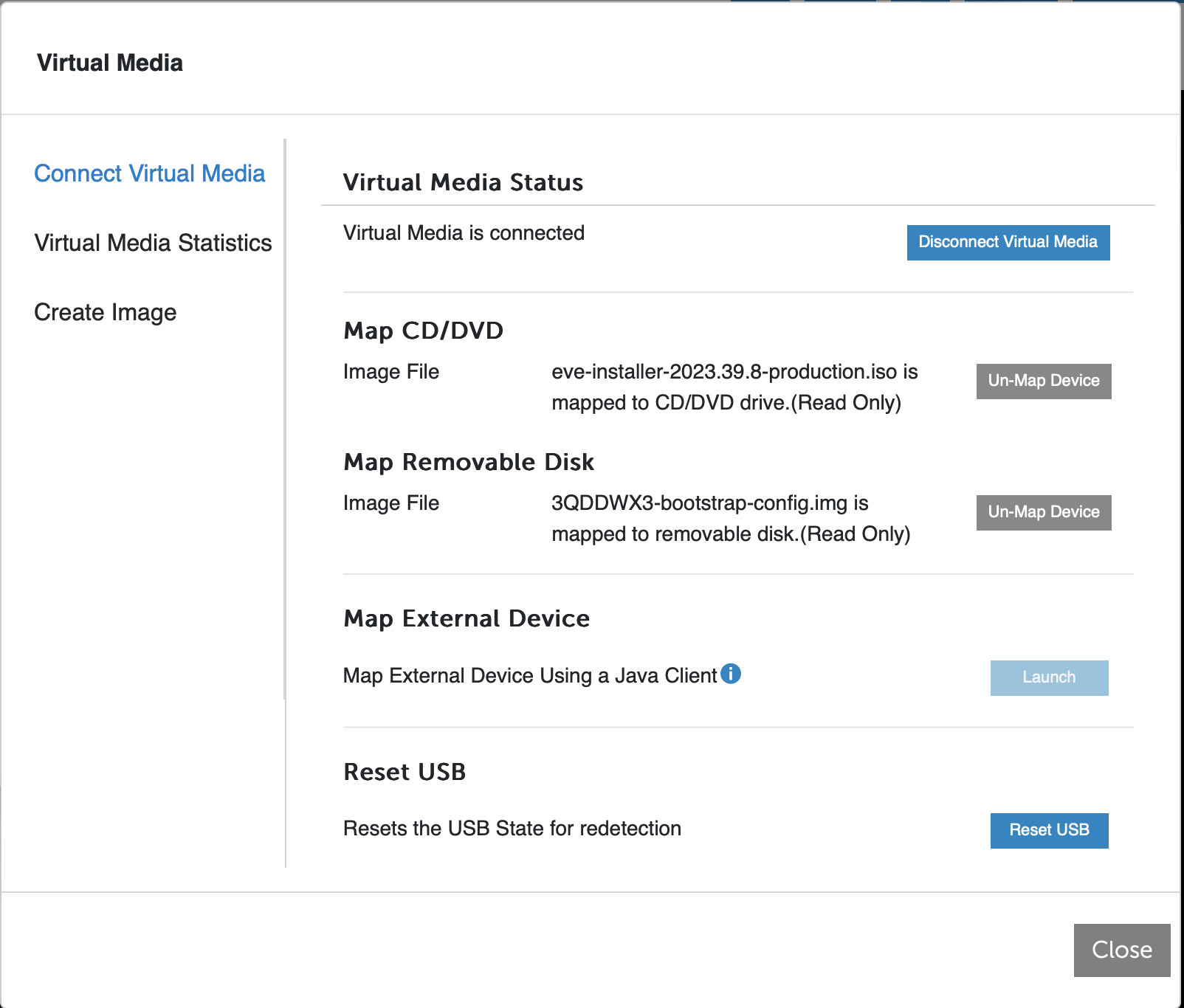

  1. Under Map CD/DVD, choose the Edge OS ISO file and click Map Device. Under Map Removable Disk, select the bootstrap-config.img file and again click Map Device. The removable disk is a virtual USB.
If you selected DHCP for the device’s management interface, you do not need to map a file to the removable disk. You only need the Edge OS ISO file.
Your virtual media dialog box should look like this: edge-idrac-virtual-console2.png Close this dialog box.

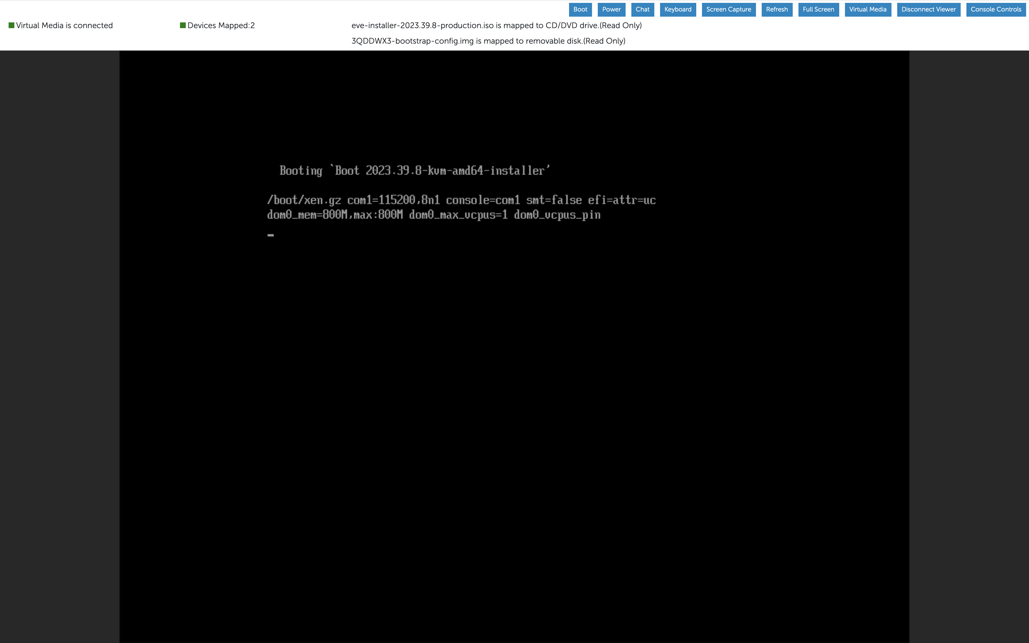

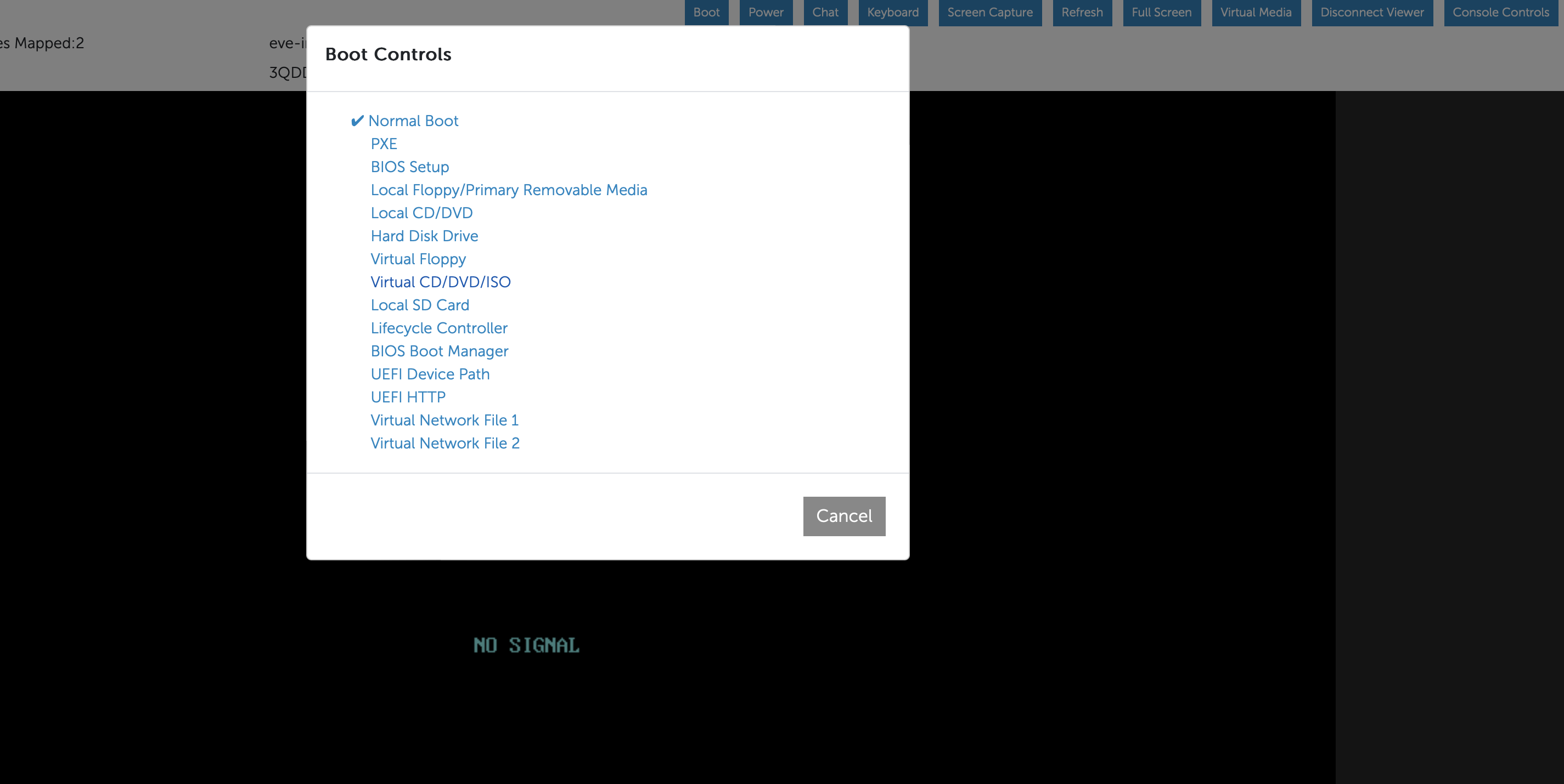

  1. From the Virtual Console, click Boot and under Boot Controls, and select Virtual CD/DVD/ISO. A dialog box will open, asking you to confirm the boot action. Click Yes.
  1. From the Virtual Console, click Power and select the Reset System (warm boot) option. This will start the installation of Aviatrix Edge OS (AEP EvE) on the server.
Do not close the Virtual console window.

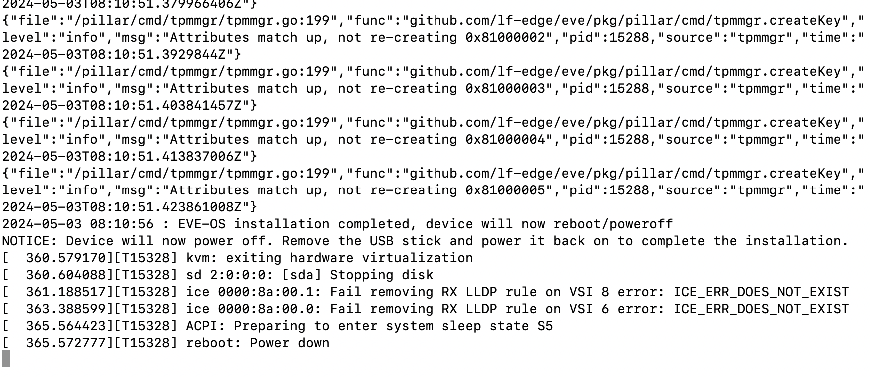

  1. The installation typically takes 10 to 15 minutes. It may vary depending on where the ISO file is being uploaded to the server via the Virtual Console.

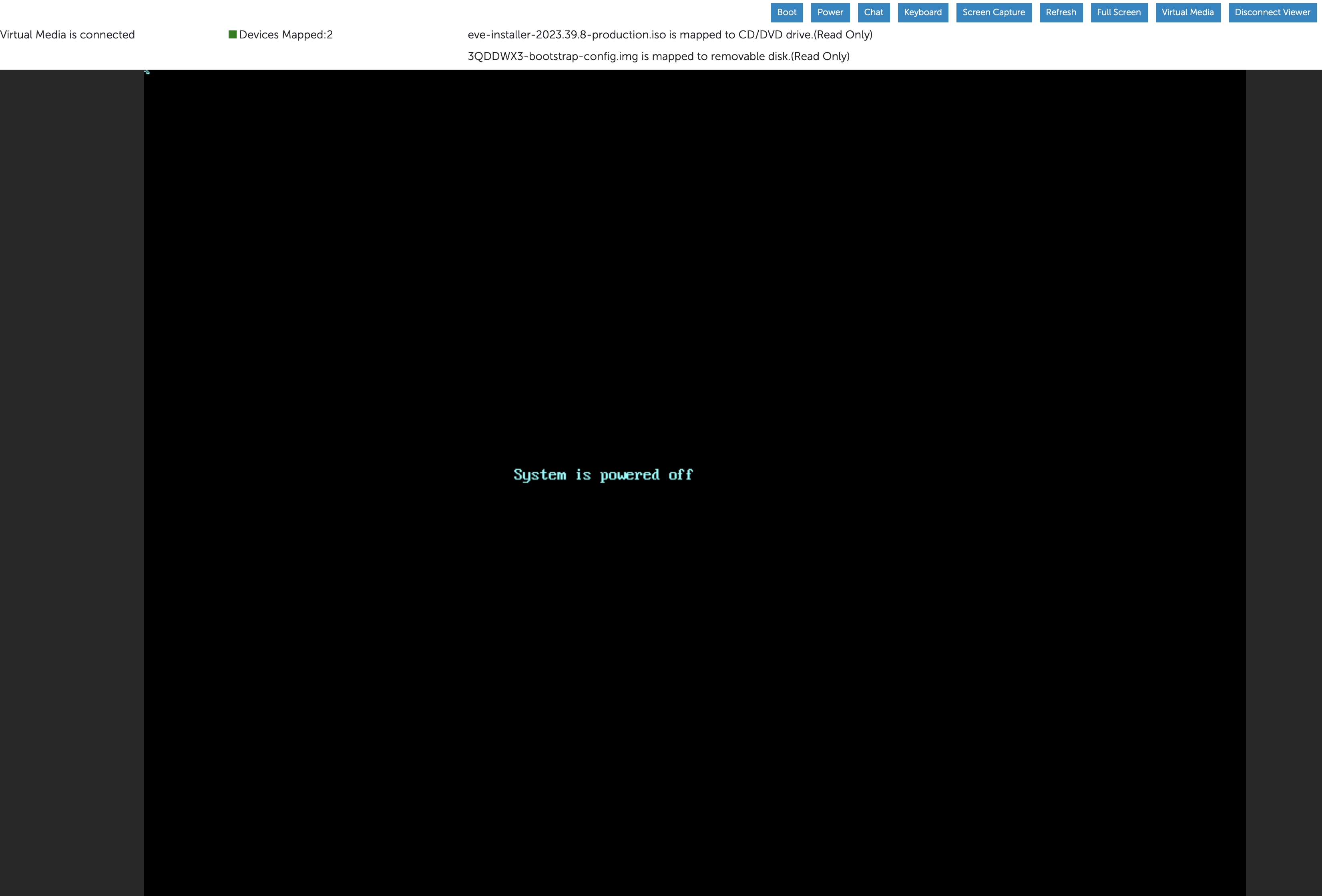

Once the installation is complete, the server will automatically power down. This can also be confirmed from the EvE installation logs in the serial console. edge-idrac-install-log2.png edge-idrac-power-off.png
  1. From the Virtual Console, go to Virtual Media and under Map CD/DVD, click Un-Map Device. Confirm the un-map action by clicking Yes. This will remove the ISO file from the Virtual Console.
If you had mapped a bootstrap-config.img file to the removable disk/virtual USB, keep it as is. The system will configure the server’s management interface with the static IP information in this virtual USB. edge-idrac-virtual-console6.png Click Close to save the changes.

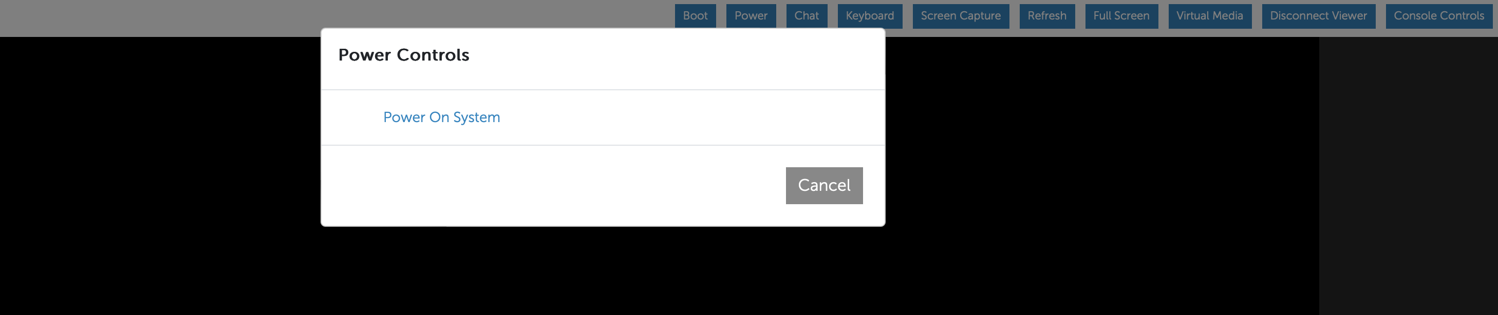

  1. From the Virtual Console, go to Power. You will see only one option this time, Power On System. Confirm the power action by clicking on Yes.

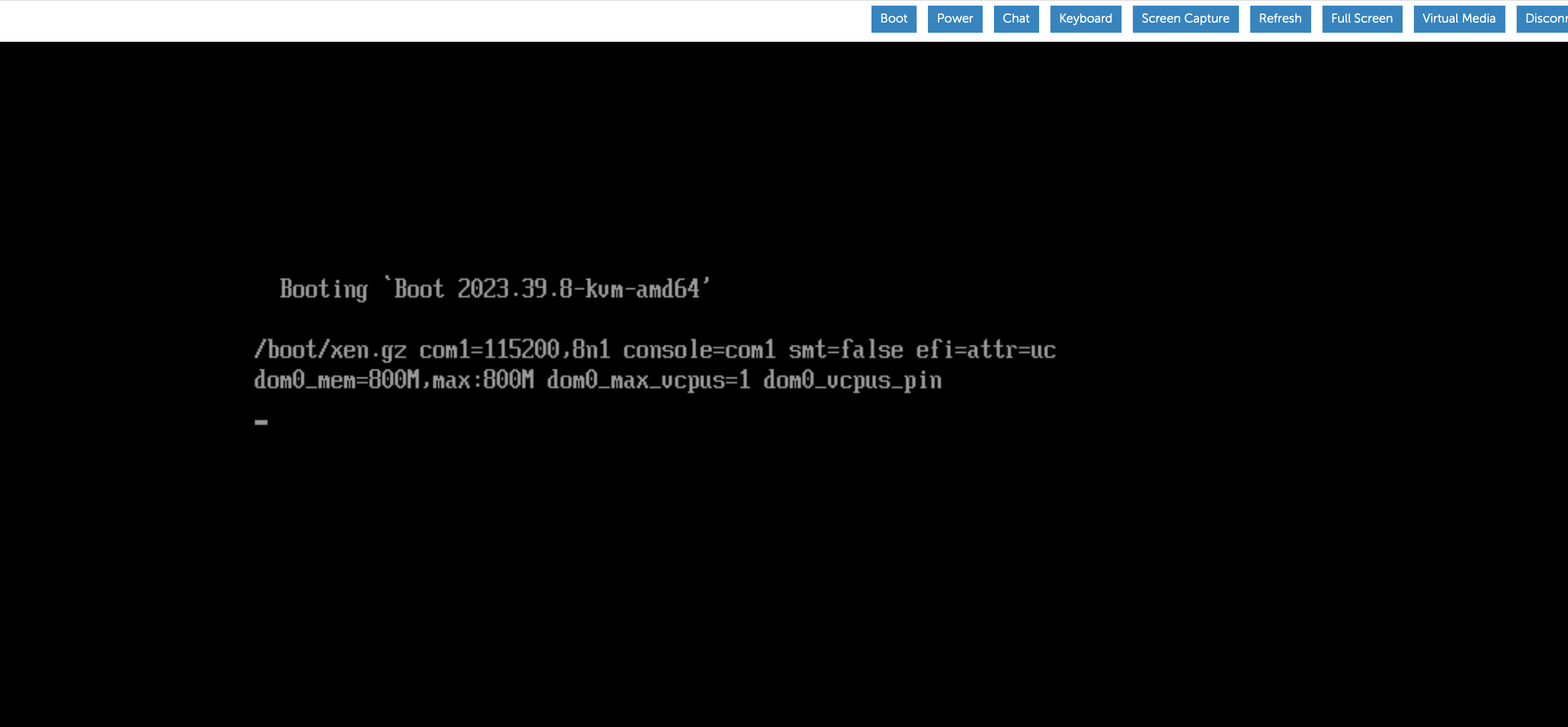

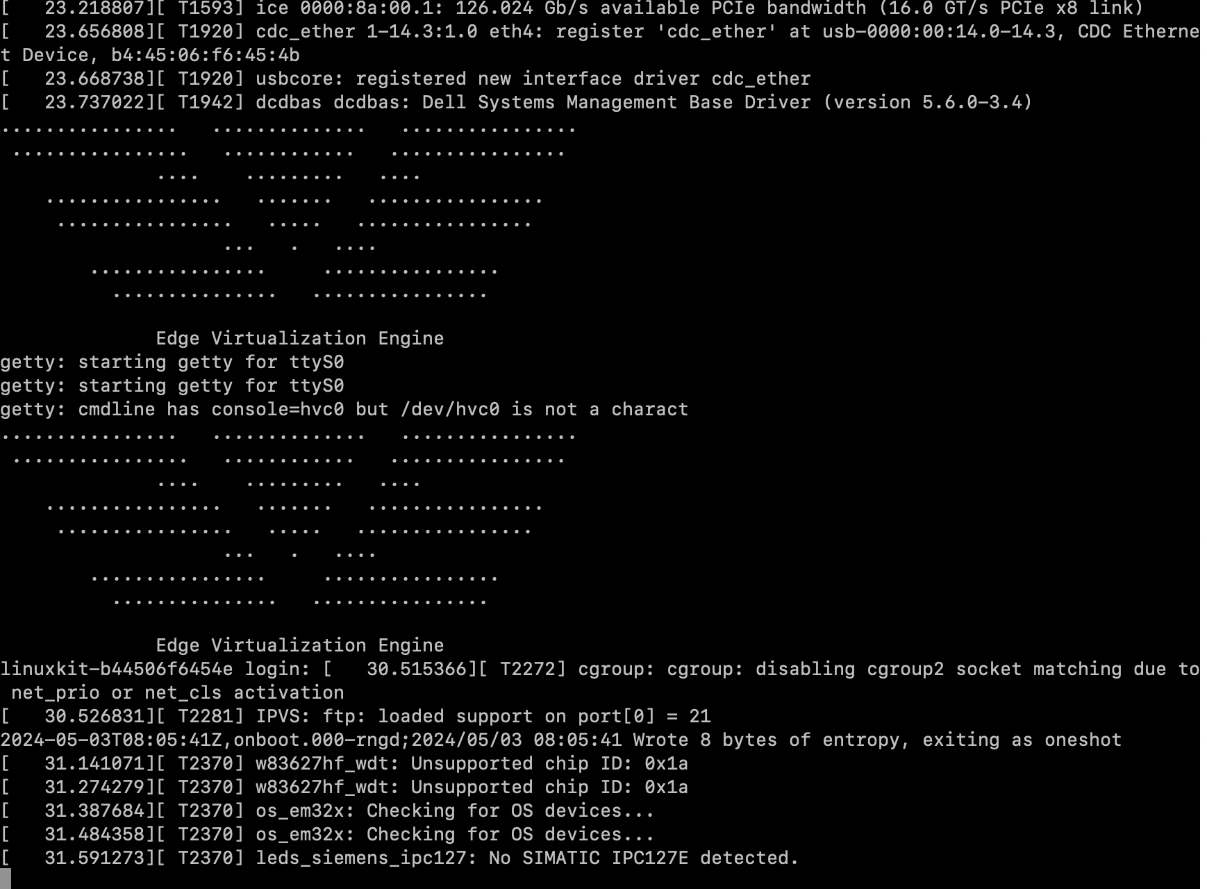

  1. Allow the server to power on. It will boot AEP EvE.

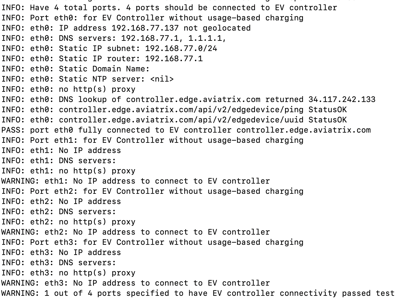

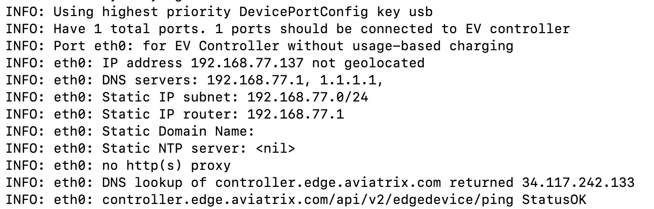

  1. If you have access to the server’s serial console, you will see the boot logs. Aviatrix Edge OS will read the static IP configuration from the virtual USB and configure it on the server. The server will dial out to AEP (controller.edge.aviatrix.com) and connect to it. Look for logs (the actual log text may vary) with these entries: PASS: port eth0 fully connected to EV controller controller.edge.aviatrix.com and 1 out of 4 ports specified to have EV controller connectivity passed test.
  1. The Dell device will show up as Connected in Copilot (go to Cloud Fabric > Hybrid Cloud > Devices) and can now be used to launch an Edge gateway. For details on how to launch an Edge Transit or Edge Spoke Gateway, see Hybrid Cloud Connectivity.
